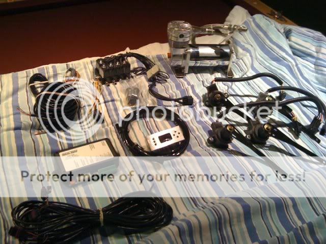

Just thought I'd post a teaser of what the kind UPS man brought. Sorry for the iphone pics, was in somewhat of a hurry!
Most of the components arrived.
Ride controller with the "brains" of the operation.

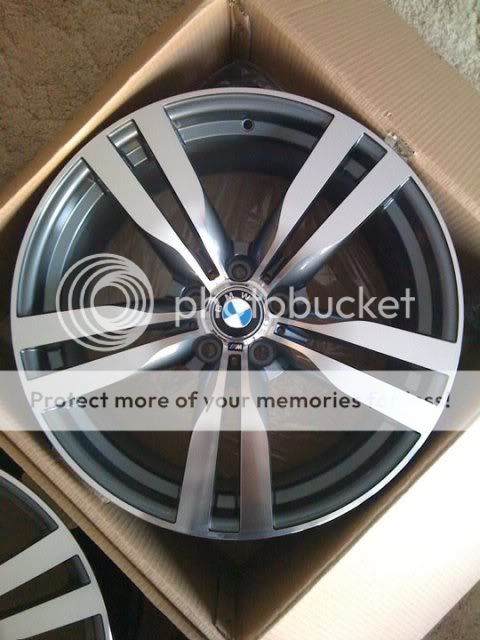

Wheels. The Bridgestone Dueler HP Sports are also sitting in the garage for these bad boys.

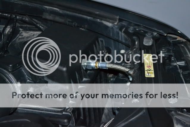

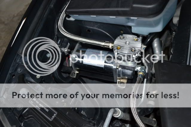

Here are a couple pictures of where I mounted the air compressor, and ran a SS line over the top of the rad to the air box securing it to the top of the rad with rubber clamps. I used the intake air filter to also filter the air for the compressor. I did have to strengthen up the air box wall just as a precaution; to make sure it would not crack after putting in the bulkhead fitting and connecting up the line. Next to mount the compressor in that location I had to fab up a bracket for it to sit on. Power wires run through the existing rubber insert for the factory harness, to a relay controlled by a pressure switch on the tank. I still have to get another bulkhead fitting to connect the main airline up to the SS line coming off the compressor. Anyways, enjoy.
Comp. Intake Line:
Comp. Mounted:
