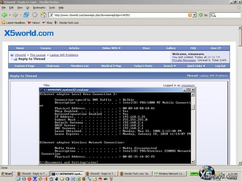

copy/paste the output from your ipconfig /all for us...
what is your default route? the fact that you are hitting 2 internal networks with one wireless device is troubling... (the 1.1 and the 2.1)

Old 05-22-2006, 06:36 PM
It won't connect to anything wirelessly.

Old 05-22-2006, 06:41 PM
hayaku's Avatar
Location: OC
Posts: 1,870
ok.. so the 2.1 network is the land line to the belkin... thats also your defaut route and how you get all your other services (DNS, DHCP, etc)
how are you getting to the 1.1? it says you are not connected at all to the wireless station there...
