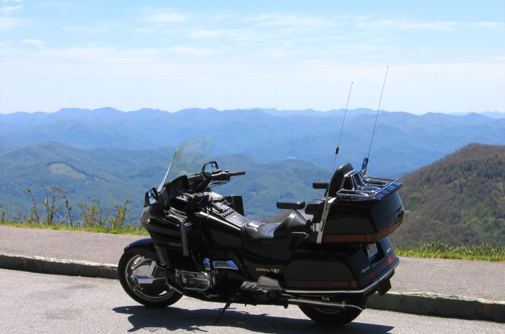

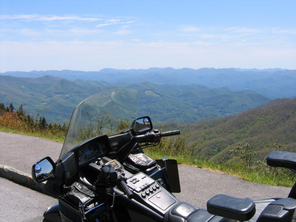

OT...
Originally Posted by x54.4blue
...do you have any photos of the Scoots?
Blue, never being one to pass up a pic posting op,
here are a few of the my '94 Honda GoldWing Aspencade
and my '87 Honda Hurrican 1000; they have been posted
before...and, a Photobucket link to the page group these
pics came from: cars, scoots, etc.
Thanks for looking!
OlUncMtr's small collection of car/scoot pics...:
