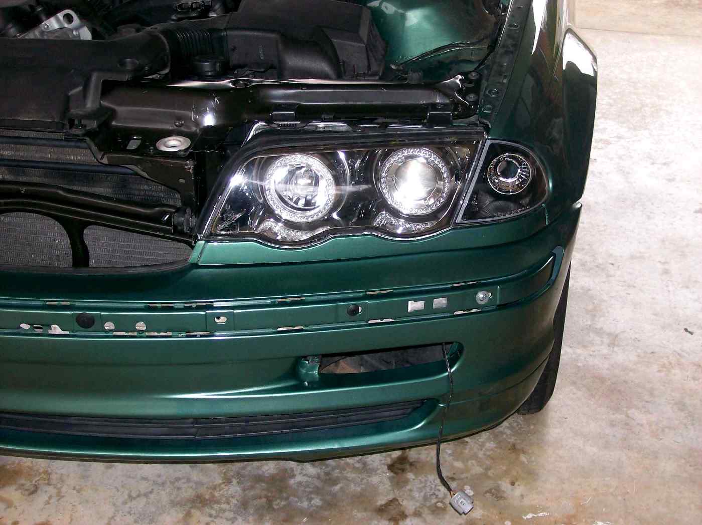

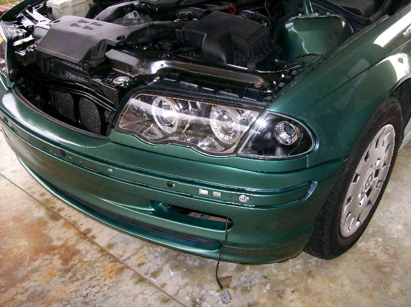

The project is progressing pretty well. I got most of the parts. Still waiting for the headlights and bumper cover. I got headlights, expansion tank and grills on ebay. I got a used radiator from a local junk yard which by chance had one in near new condition. I got the hood, bumper cover and front frame panel from Advantage Auto Body Parts of Texas. They were about 40% less than the Online BMW parts catalog and less expensive than other place I called. The only problem is that they sent me a wrong bumper cover. They sent me one for a E36 and not a E46 I called them today and they will send me the right model ASAP. They told me to keep the other one as they do not want to pay for shipping it back. Anybody on this board who needs a brand new e36 front bumper cover assembly let me know. Today I finished replacing the radiator, expansion tank and front frame panel. Before putting all this back together I inspected the belts and water pump and found them in very good condition. I filled in new coolant, bled the cooling system (took me a while to bleed this damned thing properly) and did some tests and everything seems to work like a charm so far. I was able to straighten the front left panel and the panel over the wheel pretty good. There is still a minor dent which I will probably ask a dent wizard to finish for me. Now I need to wait for the rest of the parts to come. In the meantime I will test my paint talent on the hood. I got one can of paint and one can of clear coat for test. If I am not satisfied with my job I will bring the hood and front bumper cover to a professional. After all I am an IT guy, not a car mechanic or car body paint guy for god sake!

I am almost done. After having replaced the radiator, expansion tank, front frame panel, etc... a couple of weeks ago I received, painted and installed the new bumpers cover and headlights yesterday. To my surprise my paint job on the bumper turned out really good. The color matches very well the original color of the car and the result really has a professional look. I bought the paint from Automotivetouchup web site (both color and clear coat). Their paint is of very good quality and it is realtively easy to get a professional finish even from aerosol spray cans. I hope to be able to do the same job with the hood, will see. I ordered more paint cans for the hood and have not received them yet. Here are some pics of the new bumper installed as well as the new headlights which have angel eyes unlike the original ones. I got both sides headlights from ebay for not even the price of 1 OEM.
